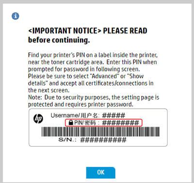

  4. Press the Information (i) button to print the Printer Information Report. The report contains the printer IP address and printer PIN.
  5. Open a web browser from computer/mobile device in same network, enter the printer IP address to access the EWS page.
  6. Click System, and enter ‘admin’ as printer user name, printer PIN as password when pop window showing up.
