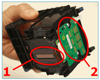

CLEAN THE PRINT HEAD CONTACTS
Sometimes the printer may have problems in the ink system, due to dirt in the copper contacts of the print head.
Before continuing, gather the following materials:
  • Water (preferably distilled)
  • Lint-free cloth. Coffee cotonettes or filters work too.
Follow the steps below to clean the head contacts.
  1. Remove the print head
WARNING: You should not touch the ink nozzles, clean only the contacts.
  1. Clean the print head contacts
  1. Replace the head
    • If these steps have resolved the issue, you don't need to do anything else.
    • If the problem persists, go to the next step
