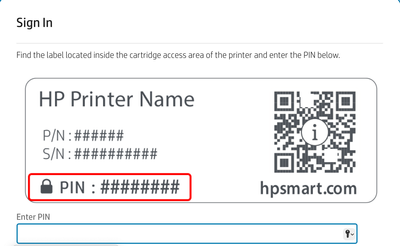

1. Open the the HP EWS (embedded web server), you can connect directly to this by opening the HP Smart App and going to "Advanced" settings; you will need to input the PIN # for your printer.
2. With access to the EWS select Quick Sets --> enter PIN for printer --> select Network Folder as the quick set type

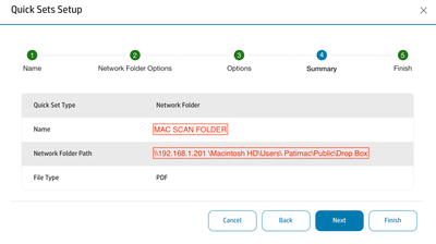

3. Name your desired quick set Name (I called it MAC SCAN FOLDER); and I selected the next option for this to automatically start when selected from the Home screen

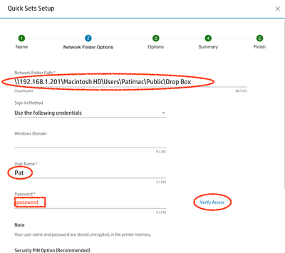

Next is the key part, the HP EWS NETWORK FOLDER PATH.
4. On your computer open finder and navigate to the folder path of the destination folder on your computer (STEP “f” above)
  Find that folder and right click on it; hold the "option" key and it will convert the "copy" to "copy "folder " as pathname"
  Copy the path name
Reminder, in our example:
a. Computer IP address is: "192.168.1.201"
b. Name of HD is "Macintosh HD"
c. Using an iMac in this example
c. User is "Pat"
d. Password is “password”
e. Destination folder is the Public and Drop Box within;
f. Navigating to this particular destination folder, highlighting the folder and then right clicking on the “Drop Box” folder and holding the “option” key then copying the file path name, it will show:
/Users/PatiMac/Public/Drop Box
5. Now return to your HP EWS Network Folder Path
Entering information into the HP EWS Network folder path:
THIS IS THE KEY TO SUCCESSFULLY SETTING THIS UP, enter the IP address for your computer right after the \\IP ADDRESS FOR YOUR COMPUTER (NOT THE LOCAL HOST NAME):
 Behind the 2 backslashes, enter the IP address for your computer
 Enter back slash “\” after the IP address and the name of your HD
 Paste the copied pathname into the window
In our example it will look like this:
\\192.168.1.201\Macintosh HD/Users/Patimac/Public/Drop Box
You must now convert the forward slashes “/“ in Mac copied path to backslashes “\”
The final path in our example set up is:
\\192.168.1.201\Macintosh HD\Users\Patimac\Public\Drop Box
For Sign-In Method select:
Use the following credentials
6. Enter User Name: Pat
7. Password - password
8. Leave PIN option blank
Click VERIFY ACCESS and it should work
Click ok to move to next step after verifying and complete the set up with the desired scan output settings.
