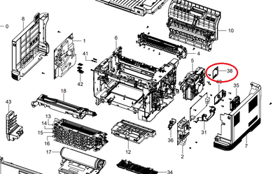

The screws on the bottom are holding the control panel attached to the scanner. Not sure will you be able to access the screws while the scanner is attached, you might need to remove the complete scanner first.
Once screws are removed the plastic hooks hold the front side of the control panel to a scanner.
04-29-2022 04:42 AM
Thanks again. Got it out this time but to my surprise there was no battery. The manual says that date&time will be held as long as the power cord us connected. Something must be broken or the battery is somewhere else. Any ideas?
