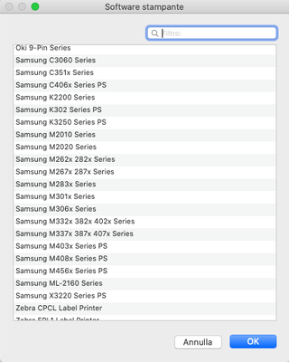

first of all thanks for your understanding. The link from the site is different from yours (https://support.hp.com/it-it/drivers/selfservice/samsung-xpress-sl-c430-color-laser-printer-series/1...), which is much better. But I find the same problems because in the list of available printers the Xpress c430W is MISSING.
So, when i try to install (or later from the system preferences when I try to add) the printer I find several printers but my model is missing.  As you can see below... I also tried to install other types of printer (you never know !!!) but obviously it doesn't work.

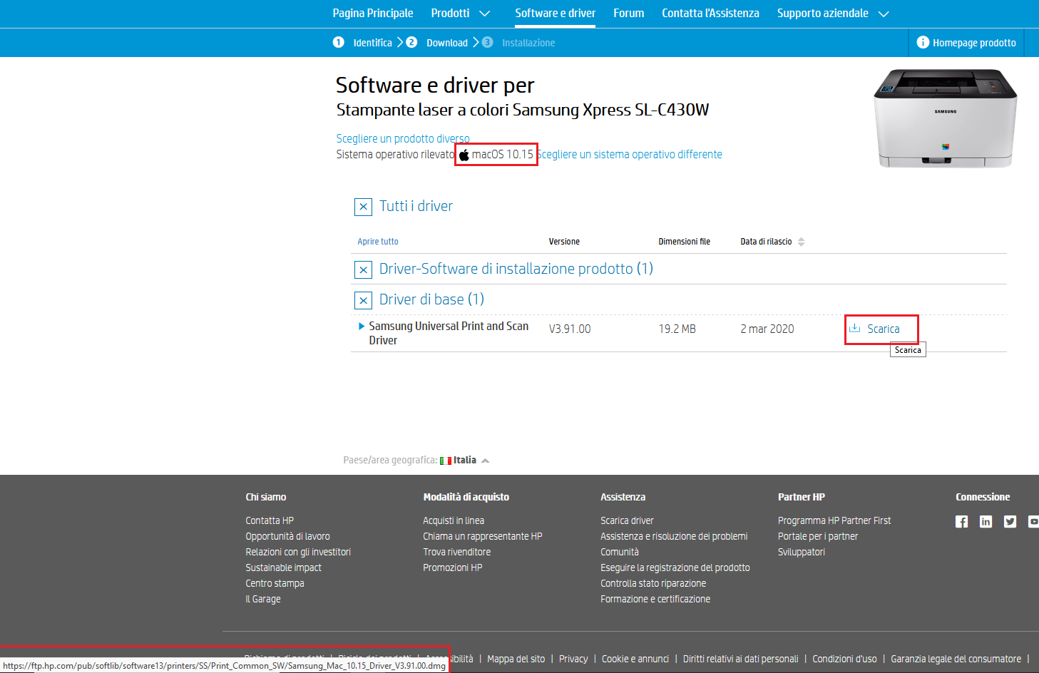

What different driver do you see? I do see the exact same driver for the Italian site when selecting 10.15 for your product, see the 430.png file attached to my post, see the bottom link, I did highlight it with a red border, it does include your printer model, I did remove any existing printer driver, installed this driver and reviews the list, which the printer model was added with no issues at all:
Now, let's figure what is the difference first, could you please attach a picture of the Add printer dialog, when clicking the plus sign), as I do see there are several printers, to get some better picture (the same image attached before, but without the error message above)

neither on the USB option nor on the second Bonjour in the list of printers appears mine. Thank you so much if you continue to help me.
