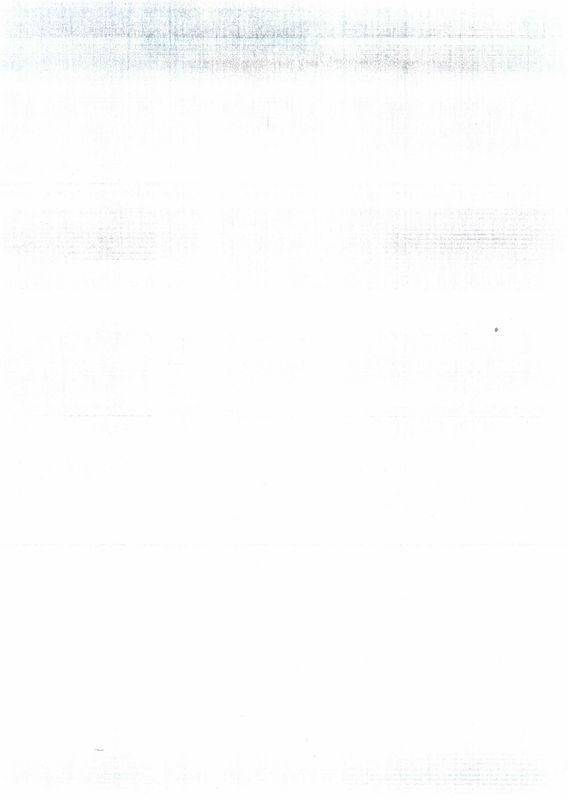

Now to the problem.  When I print after not printing for a few hours it prints blank pages. If I go to Preferences and change any settings ( Best to Normal, Color to Black  doesn't seem to matter just any change) it will then print VERY light and with a page that looks like the image unit is bad (gray bans on the print etc).  If I reset from the on printer menu SOMETIMES it will give a clear print.  If I unplug the unit for about 30 seconds then I will get a clear print. It will look like nothing was ever wrong.

Can you post a sample for me to look at?

Not sure it will help but I have inserted 3 samples. One is an example of the blank print that occurred after hours of no printing. The second is after just changing a setting in Preferences. The third is after unplugging the printer for 30 seconds.  Each is a print from printing the test page.  The black dot you see on the right side of the first 2 prints is the result of something on the scanner that I removed before the 3rd print. I will say that USUALLY the second print has a bit of faded hard to read  print. Maybe it did not show this time because I was using the Test page.
Sample of blank page first attempt print.jpgSample of print AFTER change in properties.jpgSample print after unplugging for 30 seconds.jpg
After adding them here I should point out that the images here are a bit faded compared to the actual prints (or the scanned images).
