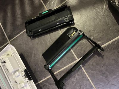

 Changed both these parts
That is the toner and the drum (imaging unit). The fuser is a completely different part that bonds the toner to the paper. It does not simply pull out, a certain amount of disassembly is required to remove it. The link I posted for the fuser would be one source you can investigate.
