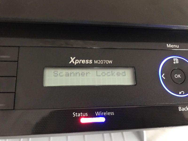

hi, anyone knows how to unlock  the scanner of Samsung Xpress M2070W?, just unboxed it. WhatsApp Image 2018-03-24 at 16.22.34.jpeg

Hi, the scanner lock is actually a physical locking mechinism. It is not a control panel option.
the scanner is locked in a safe position before they ship the unit to prevent damage to the scanner.
I believe that this sliding latch can be located ( while looking straight at the unit ) on the under side of the scanner, above the area where the paper comes out, more to the left hand side.
locate the latch and slide it from the locked position to the unlock position.
Press stop/clear button to clear the error and try again.
