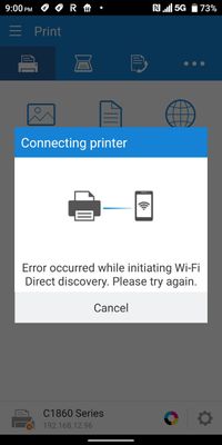

I am trying to connect my Samsung printer via Wi-Direct but fail to do so. It is recognized fine by Samsung Mobile Print App when I connect via Ethernet to my router, but is not recognizable via Wi-Fi, probably because my router is too new, the WiFi network is on WPA3 encryption that printer most likely doesn't support. So I want to connect via Wi-Fi direct.
This is the error when I tap the phone to the NFC tag on the printer and initiate connection:
Sometimes it goes further
But in the end it fails anyway
I have Samsung Mobile Print 4.08.041 and Samsung Print Service Plugin 3.10.240620 installed.
In this Wi-Fi Direct guide I see that HP Smart App should be installed, but I was thinking this applies to HP printers only, and Samsung printers are managed by Samsung Mobile App. Is it?
Could you please suggest how to resolve the error?
P.S. I also checked this article https://support.hp.com/us-en/document/c06634545 but it is not very applicable to me, and I don't have WPS button on my printer either.

Thanks, suddenly I was able to connect to the printer via manual way, which wasn't the case before. Maybe cache clearing helped, indeed.
@Sneha_01 wrote:
Manual Connection: If the NFC method isn't working, try connecting manually:
  • Go to the printer's Wi-Fi Direct settings to find its network name (SSID).
  • On your Android device, go to Wi-Fi settings and look for the printer's Wi-Fi Direct SSID.
  • Connect to it directly by entering any required password (usually found in the printer’s manual or settings).
Now I am able to print from phone. Thank you!
