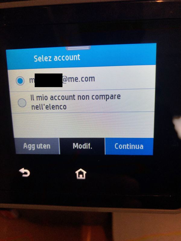

if i scan directly from the device (scan to email) the result is extremely dark. on the other hand, when i scan from the app, the result is good. what can i do? it looks like the settings default are wrong (and i'm not able to change them operating directly on the device)

Thank you Jay_G24,
I tried the first option, but there are no settings options. I can only select the email i want to send the document to, and i can select if it has to be a document or a picture. That's all
Below are the pictures of the 5 steps on the display and a picture of a document that I scanned.
For what concerns the 2nd option, I don't know how to do that. Would you be able to give me more instructions? But also, why should i do something like that? it is a scanner and i only want to scan a piece of paper and make sure it is not too dark... why should i learn how to use EWS for that?
Also, when I tried the first option, i also tried to delete the account that I had registered (the email address that I send the scanned documents to), because i wanted to re-enter it and see if there were option to calibrate the scanner. When I tried to re-enter that email address (which now doesn't appear in the list) I am told that the email is already existing and i can't add it it again...

I am unable to view the images you have shared.
