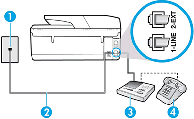

I confirmed the setup where a line runs from the modem to the fax/printer Line 1 and another line runs from the EXT to the base of the cordless phone. I changed the fax speed to slow as I thought that may have been an issue. I still get the message that the fax line is busy. Do you have another suggestion, any help would be greatly appreciated.
@IronLionBKNY I suggest you disconnect the phone and check if it's working fine, and if the phone isn't working as it should, please contact the phone company for assistance in resolving this issue,
That said, if the phone works fine, check all the connections and ensure its as explained in the below image, also let me know if you are able to receive a fax.
  1. Wall jack
  2. Two-wire phone cord
  3. Answering machine
  4. Single-line telephone
I hope that answers your query,
