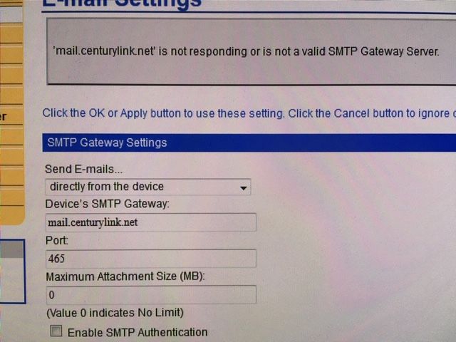

Thank you for the reply.  I have gone through this page in the manual; but I'm not getting anything sent from the mfp.
I get the response; "E-mail is not responding."  Within the help box is the message; "Administrator?"  There is no additional help.
I am not an administrator; and one is not available.
Is there a better example or tutorial on the setup process than what is available within the user manual?

Do you have an SMTP gateway? What happens when you enter your SMTP gateway and press test? I hope you didn't enter  16.234.33.148 for your SMTP gateway because we use different gateways on our networks.

Nope; didn't enter 16.234.33.148.  My skills are a little above parroting the example.
When I do a Find Send Gateways; I get "Gateways Failed."
The option of Send To Folder does not let me specify a folder.  Is there a way to do that?
Don't use find gateway option, you need to manually enter your gateway and apply test option to check. Configuring a send to the mail should be a 3-minute job.

I'm ready and have 3 minutes.  How do I find my gateway?
It's a 3-minute job if you know your SMTP gateway. How is your email configured?
Google search: how to find SMTP gateway
