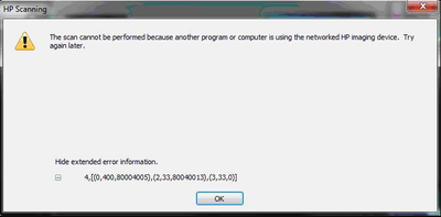

but after a long break in work, I decided to plug it in and scan. As a result, more than one application cannot do this. When trying to scan through the HP Solution center. An error occurs: "The scan cannot be performed because another program or computer is using the networked HP imaging device. Try again later." Hide extended error information.
4, [(0.400.80004005), (2.33.80040013), (3.33.0)].

@TEJ1602 I have tried reinstalling all software and uninstalling all printer drivers and devices. Including I did what you suggested. I even tried it on another computer that I never connected a printer to. The problem remains. Thanks for your answer, but unfortunately. won't help me.
Probably the problem is in the printer itself, maybe there is a way to reset its internal settings or something like that?
