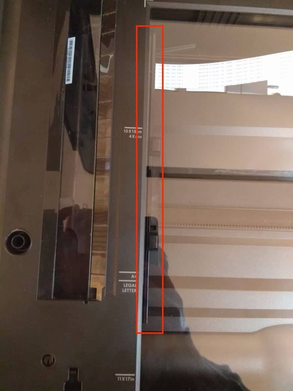

I am assuming that the main problem is, the scanner head not making it to the starting place when it completes a scan job and that's why I am able to scan one or two documents before the printer starts saying "unable to scan".
I took this photo after the printer went into "unable to scan" mode and as you can see the scanner head is a little outside, sorry about the reflection though.
@FayPan
I'm afraid, its a possible scanner bar failure. Please call HP Support to obtain all available repair/replacement options. You may use the following steps to contact your regional HP Support:
