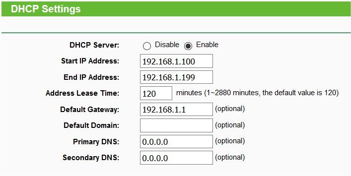

Here are my settings...
Found it!  Hadn't noticed that the router was in Basic mode so lots of the settings were hidden.  Here you go
There you go!  You have NO static IP space in your router.  All addresses are DHCP.
Change your start to 192.168.20.100
Change your end to 192.168.20.150
Change your static IP in the printer to 192.168.20.10  As you can see this is now OUTSIDE the DHCP window of the router.
Your DHCP address are now .100 thru .150.   50 DHCP address available... plenty.
Static IPs.  .2 thru .99 and .151 thru 254.  Plenty.
Remember the router is at .1 (192.168.20.1)
Now do the rest...
