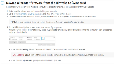

I've download the updated firmware following the instruction below
and get this dialogue box, click on the send firmware then finally get a smiley on the dialogue box.
After these, I tried on HP Smart, issue persisits, uninstall and reinstall, issue persists.
