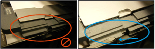

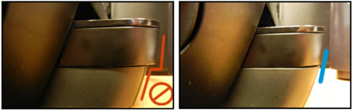

Ensure the Photo Tray is Correctly Seated: Verify that the photo tray guide tabs (grey) slide beneath the main tray guides (black) on both sides.
Making sure the photo tray is seated correctly
Adjust if Necessary: If the guides are not aligned, gently reposition the photo tray to align the tab gaps, then press the tabs back into position carefully.
Aligning the tab gaps
