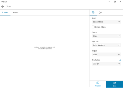

HP Scanner Problem.pngStarting yesterday, all 3 of our M570dns won't scan from the desktop using the Windows 10 HP Smart scanner app.  When I click the scan button on the scan screen, I get an error message "Scanner Not Found", "The device could not be reached".  When I look at the web interface for the scanner, the status for the particular scanner changes from "Ready" to "Scanning to computer".  I can print to the printer.  I can get to the web interface.  I was already running the latest firmware.  The version of HP Smart is 127.1.115.0.
All the printers are plugged in by hardwired network.  They've been working pretty flawlessly for a year or so.  Nothing has changed.  I've done the procedure I found here that said to pull the power while the printer is powered up, hold the power button for 15 seconds, then plug back in.  I've updated the Windows drivers and software.

Thanks for the quick reply.  I've done that a couple of times from multiple machines to all of the printers.  Same results: "Failed to communicate with selected product".  Even though the web page is still accessible and I can still print.
