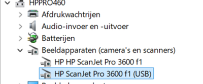

To find out which Id's to prevent from installing I opened device manager > Imaging Devices. It lists two devices: HP HP Scanjet Pro 3600 f1 and HP Scanjet Pro 3600 f1 (USB).
The first one is the one I wanted to get rid of. So go to Properties > Details and find the heading 'compatible IDs'. In my case they were:
1284_CID_MS_ESCL
SWD\GenericRaw
SWD\Generic
1284_CID_MS_ESCL
SWD\GenericRaw
SWD\Generic
