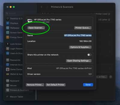

HP Officejet Pro 7740 - Mac - OS Sonoma 14.4.1 (though this issue persists on other devices with older OS's too)
My scans over expose light areas. Scanning images that, for example, contain shades of light or even medium color, will show those areas as white, same as the areas that are actually white. Some of the other areas that contain darker tones scan properly. But lighter details get washed out, as if they don't register. This does not improve if i change scan resolution, file type, etc. I use the standard scanning interface on macs, seen below. See also the scan image in the interface as well as the photo of the actual material being scanned. Looking for any insight on what can be done to get a full range scan. Perhaps another scanning interface or software? Thanks all.

To add. I've just downloaded and toyed around with HP Easy Scan. Same washed out results.

The HP Smart application was the successful suggestion from Rachel's comment. Additionally, turning off the "Auto Enhancements" feature gave much better results.
