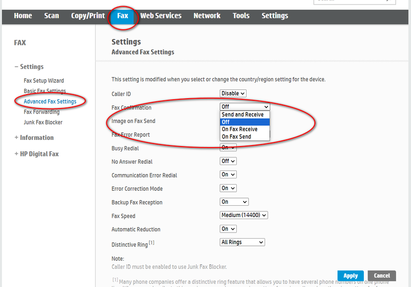

Hi, I have a new HP Color LaserJet Pro MFP 4301fdn Printer at my library and I need to find a way to get a printed fax confirmation sheet to give my patrons when they send a fax. I cannot find anywhere on the machine itself or on the digital portal to this. Is it possible to get a printed fax confirmation for each job and, if so, how?

See my screen capture below for the location of fax confirmation. Really sad that they do not document all functions in the instruction manual.

Thank you so much for responding, and for including a screenshot! Unfortunately I don't have the "Advanced Fax Settings" option on my menu. I'll include a screenshot of what I do have, just in case! I looked through all of the fax options for something similar to what you circled (the fax confirmation dropdown) and couldn't find one. I agree - it is sad that it's not in the manual! Again, thank you for your help!
