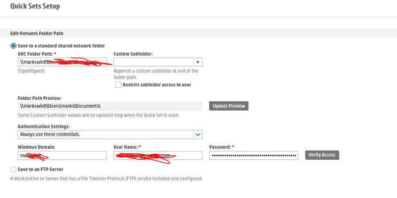

You must save the credentials when you create the scan to folder by selecting "Always use these credentials"
If not on a domain use the workstation name as the domain name and a user and password that has access to that folder.
