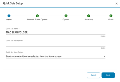

1. Open the the HP EWS (embedded web server), you can connect directly to this by opening the HP Smart App and going to "Advanced" settings; you will need to input the PIN # for your printer.
2. With access to the EWS select Quick Sets --> enter PIN for printer --> select Network Folder as the quick set type
3. Name your desired quick set Name (I called it MAC SCAN FOLDER); and I selected the next option for this to automatically start when selected from the Home screen

Click VERIFY ACCESS and it should work
Click ok to move to next step after verifying and complete the set up with the desired scan output settings.
