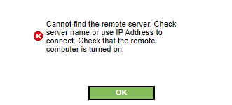

Hi, I cannot scan to the Network folder due to an error:
I can print to this printer. Checked and verify network connection, no issue found. I tried troubleshooting in older posts, none of them helping.

Hi @Shiva90,
Welcome to the HP Support Community
I understand you are facing a scan-related issue with your HP Color LaserJet Pro MFP M283fdw. Not to worry I will help you to get a resolution to resolve the issue.
Let's perform a power drain:
  • With the printer turned on, disconnect the power cord from the rear of the printer and also unplug the power cord from the wall outlet.
  • Remove USB cable, if present.
  • Wait for 2-3 minutes, press and hold the power button on your printer for about 30 seconds to remove any additional charge.
  • Now plug back the power cable straight to a wall outlet without any surge protector or an extension cord (This is important) and then plug back the power cord to the printer.
  • Turn on the printer and wait till warm-up period finishes and the printer is idle
Update the printer firmware
  • Click here to download and install the latest printer firmware from your product
  • Click here to know different methods of updating printer firmware.
If the issue persists, then please follow the steps mentioned in this document: HP LaserJet Pro MFP - Set up the Scan to Network Folder feature
