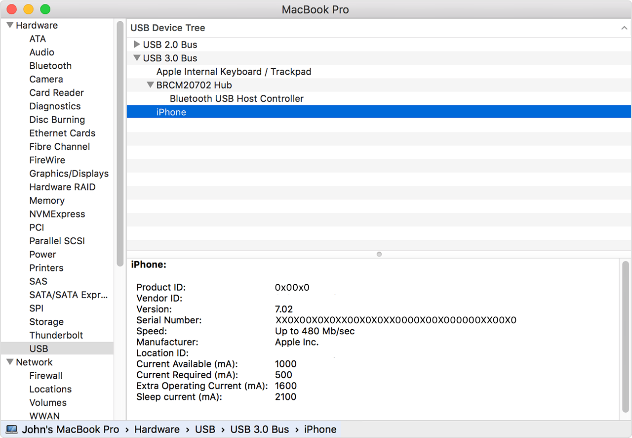

  • From the Apple menu, choose About This Mac.
  • Click System Report.
  • Under the Hardware heading on the left side of the System Information window, click USB.
  • USB 3 devices appear under USB 3.0 Bus, and USB 2 devices appear under USB 2.0 Bus.
  • The Scanjet should be under the USB 2.0 Bus
