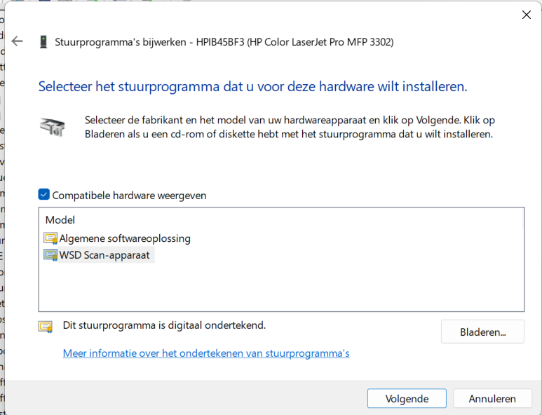

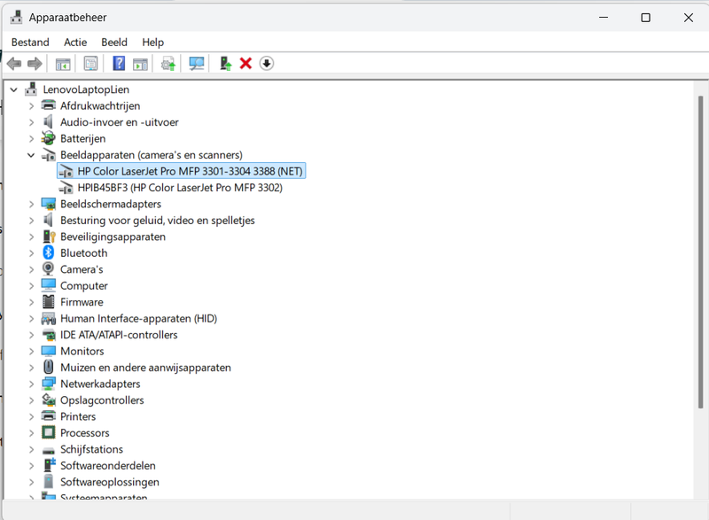

Hey @Max3Aj,
I'm not sure if I have a Twain driver installed and I don't get any possiblity to select a TWAIN Driver during the install processes. HP Scan & HP Easy Start are the software tools that are always suggested if I'm searching for drivers/software for my printer.
These are all step through wizards where nothing can be selected / customized.
Each post I've found on HP TWAIN DRIVER sends me to HP support page where it can not be downloaded individually.
These are the 2 entries that are listed in the device manager:
The driver settings for the first one lists:
The other one:
These are the scan sources that I can select in the medical software:
