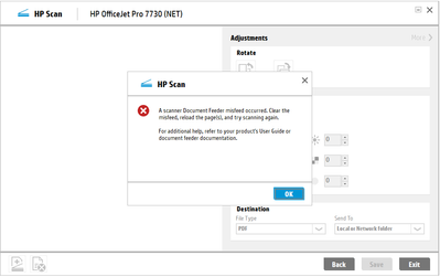

HP OfficeJet Pro 7730  feeder is feeding  2/10 pages, and then it stops in the middle of the 3 page, and  then displays error message:
And this error message on the desktop, as you can see he didn't scan first 2 pages.
I have tried turning it on and off again, cleaning the feeder, multiple times, but the problem persists.
Also, I have tried HP printer and scan doctor and it shows no problems.
Printer is scanning from the scanning glass, but not from the feeder.
I have been using it for the third year, and it worked ok, I didn't have any problems with scanning or printing, until now.
