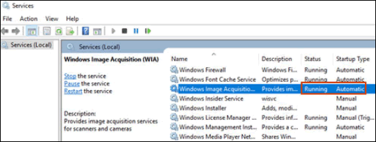

Check Windows Image Acquisition settings
Windows Image Acquisition (WIA) allows communication between the computer and the scanner. If WIA is not on or running correctly, scan jobs can fail.
  1. In Windows, search for and open View local services.
  2. Next to Windows Image Acquisition (WIA), check the Status and Startup Type.
    • If the status is 'Started' or 'Running' and the Startup Type is 'Automatic', WIA is working correctly. No further action is required.
    • If the status is 'Disabled' or blank, continue with these steps.
Windows Image Acquisition service status
  1. Right-click Windows Image Acquisition (WIA), and then select Properties.
  2. On the General tab, select Automatic from the Startup type drop-down.
  3. Under Service status, click Start.
  4. If the Start button is grayed out, return to the Services list and make sure the following services are running and set as Automatic.
    • DCOM Server Process Launcher
    • Remote Procedure Call
    • RPC Endpoint Mapper
    • Shell Hardware Detection
  5. Try to start WIA again.
  6. Now try scanning
