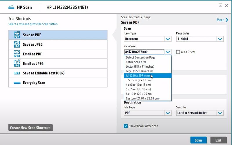

Under HP Scan, there is an option to select Page Size.  Select Entire scan area .

Thanks for your response. I have the screen you posted so does that mean I have the full featured software? I have also set the page size and selected scan entire area. It does not solve the problem. I am using the scanner through PaperPort 14 but when I press "scan" it takes me to the HP interface (the screen you posted).

Can you try to fix the output page size?  Click on the "More" at the top right hand corner to get to the picture below and set the Output Page size.
If that doesn't work, can you try to scan just using the HP Scan instead of Paperport?

I came up with a workaround. I can use the HP Scan and I found how to have it direct the scanned document to my PaperPort desktop. It's a few extra steps than it should be but it will work. I have tried setting up the output paper size when using HP Scan through PaperPort but it does not seem to respect that setting. Thanks for your help!
