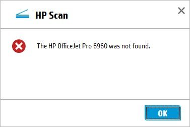

One more pic; this comes up EVERY time I attempt to access the scanner using any of the various HP options.  First pic below is what happens when trying the HP Scan utility.

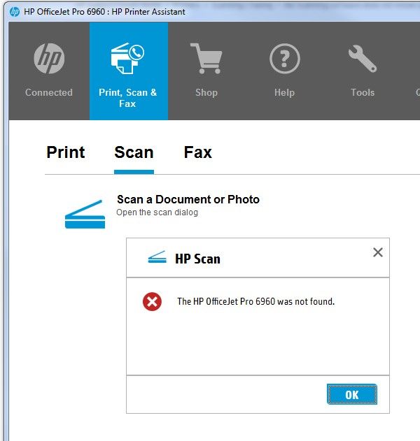

Second pic is from the HP OfficeJet Pro 6960 application and selecting "Scan".
