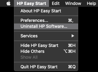

1. Download HP Easy Start
2. Open HP Easy Start and Select the HP Easy Start Menu in the macOS menu bar.  In this menu select Uninstall HP Software.
3.Select Continue to start the Uninstall process
