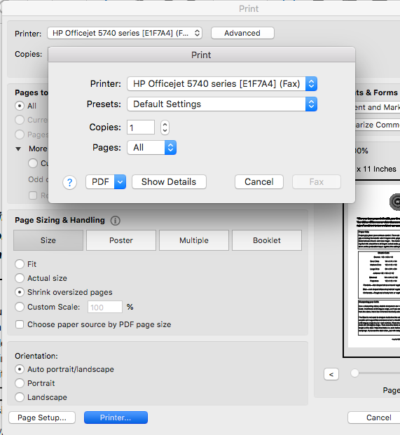

I have the same problem in El Capitan. Since there are no plans to create the driver that brings up the fax dialog on Mac OS, why does the user guide provide detailed instructions for faxing specifically from a Mac (see below)?
Even worse, the driver displays a "print" button and allows us to send the document to the print queue, which then processes the document and lists it as "completed," leaving us wondering if something was actually faxed, and to whom! I just spent 45 minutes trying to figure out what was wrong, when it would have been so easy to tell us in the guide that it can't be done (or where to go to find out if that situation has changed). This shows disrespect for Mac users' time.
To send a standard fax from the computer (OS X):
1. Open the document on your computer that you want to fax.
2. From the File menu in your software, click Print.
3. Select the printer that has “(Fax)” in the name.
4. Enter a fax number or a name from your Contacts that already has a fax number entry.
5. When you have finished filling out the fax information, click Fax.
The message string says SOLVED, but it doesn't seem solved.

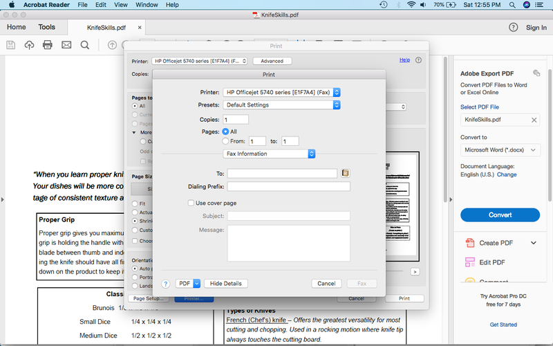

To fax a non-printed document (PDF file, for example), I go to:
Print->(Choose the All-in-One Printer/Fax)->Printer...->Show Details
This brings up the Fax Information field: Fax Information, Fax Options, Layout...
Enter the Fax Number (and any prefix, but from home, it's normally just like any long distance call)
That works for me, though I can't find a way to send a Sheet Feeder document without doing it at the All-in-One itself.
