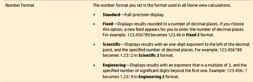

From, the User Guide, page 20-Chapter 2 - Getting Started, you can see ...

Read, in muy first post, the Description, of Engineering Notation.

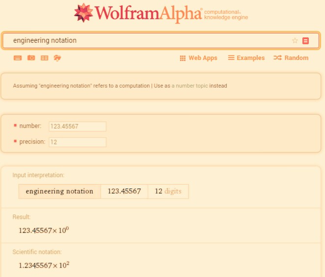

Check, with Wolfram Alpha, with 12 digits precision, same what have, HP PRIME GRAPHING CALCULATOR.

The ENG setting is not digits "after the decimal", but rather 3 digits "after the first number". The problem here is that the calculator has 12 digits of precision. If the setting was 3 digits after the decimal, you could easily say 12345678901234567890.123 should be the correct number to display even though it has more digits then the calculator can represent. Make sense?
