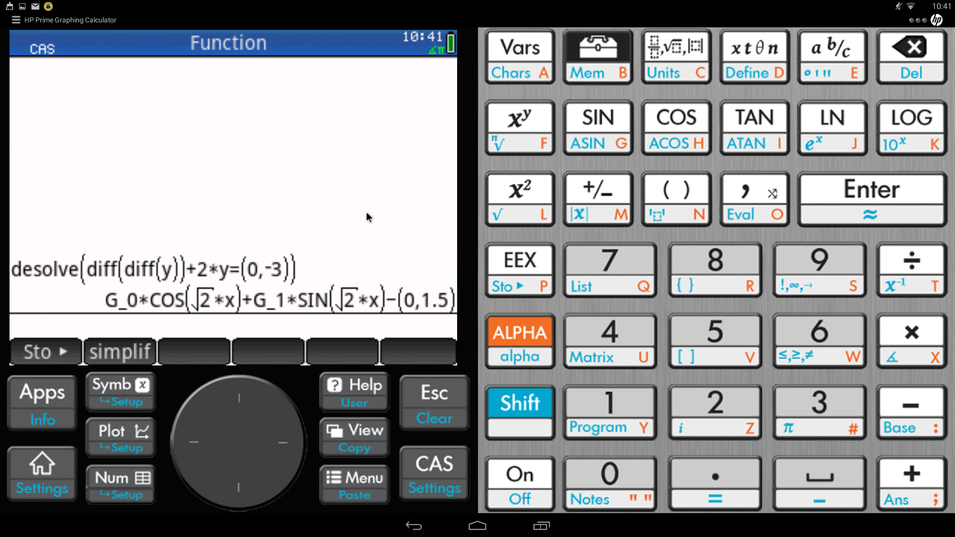

Don't understand how to solve this differerntial equation on my HP Prime, Help please!
y'+2y=0  (0, -3)

Hi!, Magqva:
See, the images ...
undefined
undefined
undefined
undefined
Kind Regards !.
Have a nice day !.
@Maké (Technical Advisor Premium - HP Program Top Contributor).
Provost in HP Spanish Public Forum ... https://h30467.www3.hp.com/
