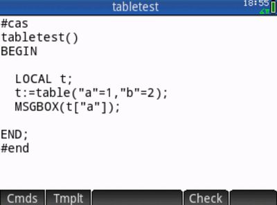

Because table is a CAS command it cannot be used simply in a non-CAS program, but in a CAS program it works:
It is also possible to use a CAS command in a non- CAS program, but then it becomes more complicated.
