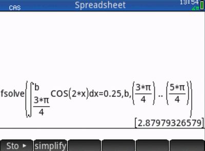

It is also possible to solve the problem numerically, and use 0.25 instead of ¼, but in that case we have to use fsolve instead of solve.
Then we get:
