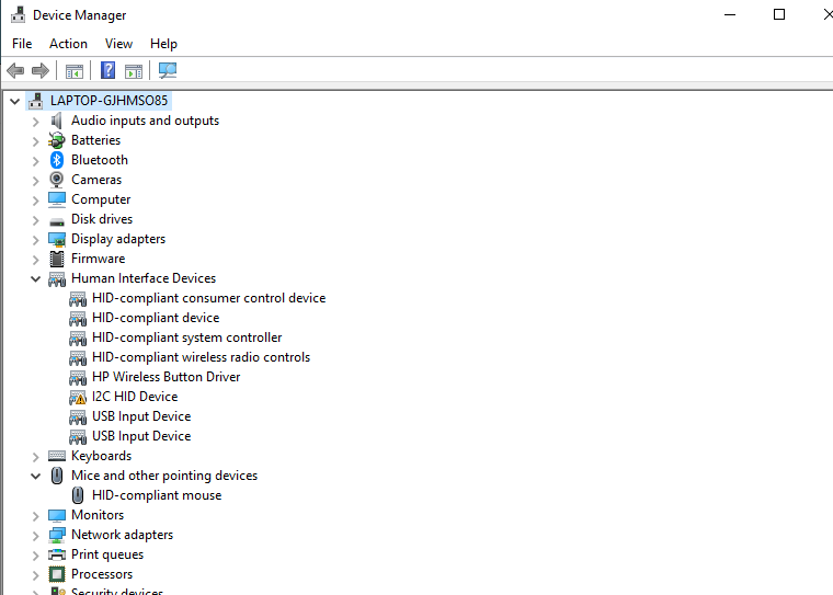

So I recently restarted my laptop and found that my touchpad was not working. The cursor would not show up and as a result the touchpad was unusable. However, the cursor does appear when I plug in a USB Mouse. After this, if I go to Device Manager and go under Mice and other Pointing Devices, I cannot find my touchpad drivers! I can only see my USB mouse drivers. I tried searching up downloadable drivers for my model (14-ck0056tu) and found nothing.  device not working.PNG

So now the I2C device that has the ! mark is gone, and the touchpad still doesn't work?
That must mean the driver worked, and something else is the matter.

I'm sorry, what is the I2C device? I do not recall seeing an "IC2", nor a ! mark. But yes, the touchpad still doesn't work. In case it was not seen, my previous reply was edited. Please see that as well.

Hi:
Look at your first post with the screenshot.  You will see an I2C HID device that had an issue (! mark next to it).
That device is related to the touchpad, which wasn't working...

Hi, I realised what you were talking about, and no, that "!" is still there.
As you can see in the screenshot above, the "!" is still there.
OK, so that is most likely why the touchpad isn't working.
See if this works...
Go to the device manager, right click on the problem i2C device with the ! mark next to it.
Select Uninstall and check the uninstall driver box too.
Restart the PC, and perhaps W10 will reinstall the device so that it works again.
