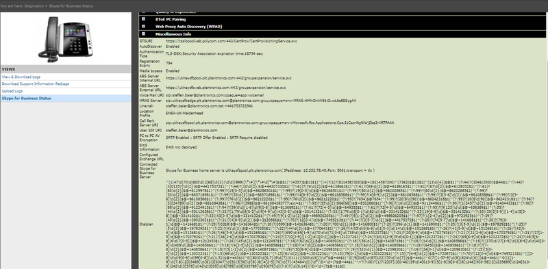

The Phone logs can help to troubleshoot issues found via  Diagnostics > View & Download Logs

Determine the general LYNC / Skype for Business status:
Diagnostics > Lync Status or  Diagnostics > Skype for Business Status
You can expand the various sections to check the individual status

Checking the Skype for Business Dial Plan aka Digitmap:
Usually, Skype for Business inbound provisions the Dial Plan and this can be checked via Diagnostics > Skype for Business Status > Miscellaneous Info
The above page shows a successfully provisioned Skype for Business Dialplan.
