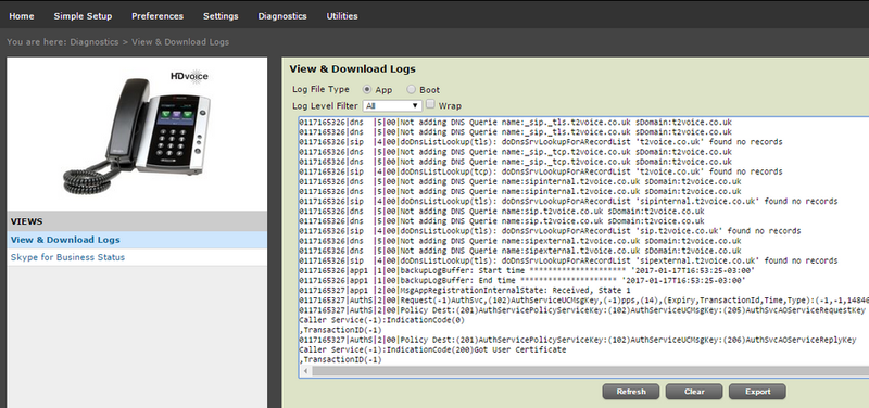

The Phone logs can help to troubleshoot issues found via Diagnostics > View & Download Logs

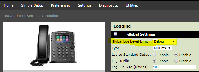

Changing of Logging Levels:
Warning: Logging parameter changes can impair system operation. Do not change any logging parameters without prior consultation with your Polycom Reseller or Polycom Technical Support.
The <level/> Parameters control the logging detail level for individual components. These are the input filters into the internal memory-based log system.
The factory default level for all logging parameters is "4" or Minor Error.

Web Interface:
Settings > Logging > Global Settings > Global Log Level Limit > Log File Size (Kbytes) >

Lack of NTP Server causing unable to sign in:
002137.009|sip |4|00|Server certificate verification failed, Untrusted Certificate 002137.010|sip |4|00|MakeTlsConnection: SSL_connect error 1
The above is the phone missing an NTP Time server!
The red highlighted Area shows the phone not having a valid time as shown => here <=
Without the time the phone cannot verify the Certificate. The Time should display as MMDDHHMMSS
0123120329|log |5|00|Skipped uploading of failed log file because no of failures are > 4 or last upload failed time is < 60 seconds.
The above shows January 23 and the time as 12:03:29
DNS Issue:
182141.243|sip |4|00|doDnsListLookup(tcp): doDnsSrvLookupForARecordList 'xxxxxxxxxx.onmicrosoft.com' found no records
182141.243|sip |4|00|doDnsListLookup(tls): doDnsSrvLookupForARecordList 'sipinternal.xxxxxxxxxx.onmicrosoft.com' found no records
182141.243|sip |4|00|doDnsListLookup(tcp): doDnsSrvLookupForARecordList 'sipinternal.xxxxxxxxxx.onmicrosoft.com' found no records
182141.243|sip |4|00|doDnsListLookup(tls): doDnsSrvLookupForARecordList 'sipexternal.xxxxxxxxxx.onmicrosoft.com' found no records
182141.243|sip |4|00|doDnsListLookup(tcp): doDnsSrvLookupForARecordList 'sipexternal.xxxxxxxxxx.onmicrosoft.com' found no records
182141.243|sip |4|00|MakeTlsConnection: SSL_connect error 1
182141.243|sip |4|00|MakeTlsConnection: connection failed error -1
182141.243|sip |4|00|Registration failed User: Username, Error Code:480 Temporarily not available
The above is the phone missing an NTP Time server and in addition, cannot resolve the DNS.
Without the DNS the phone is unable to connect to the server. You need to fix your DNS

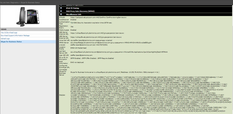

Determine the general LYNC / Skype for Business status:
Diagnostics > Lync Status or Diagnostics > Skype for Business Status
You can expand the various sections to check the individual status

0314114138|sip |3|00|UA Client Non-INVITE REGISTER trans state 'callingTrying'->'completed' by 480 resp 10 timeout(0x4129f548)
and
0210085012|tickt|1|00|[StdRet soWebTicketO365Info::soWebTicketFetchADFSToken()]:[7115]
0210085012|tickt|1|00|Provisioning:Cipher suite = ALL:!aNULL:!eNULL:!DSS:!SEED:!ECDSA:!IDEA:!MEDIUM:!LOW:!EXP:!ADH:!ECDH:!PSK:!MD5:!RC4:@STRENGTH
0210085013|tickt|3|00|[StdRet soWebTicketO365Info::soWebTicketParseSoapError(UtilRapidxmlParserC*, S_SOAP_ERR_INFO*)]:[7857] Start
0210085013|tickt|1|00|[StdRet soWebTicketO365Info::soWebTicketParseSoapError(UtilRapidxmlParserC*, S_SOAP_ERR_INFO*)]:[7949] csFaultCode [] csReasonText [] csDetailErrorValue [] csInternalErrorCode [] csInternalErrorText []
0210085013|tickt|1|00|[StdRet soWebTicketO365Info::soWebTicketFetchADFSToken()]:[7189] curlReturn [0] resCode[415] pResponse[ ] bRetVal[-1]
0210085013|tickt|0|00|soWebTicket: msg 7003 0 4b 44d4308
0210085013|tickt|1|00| FSM : Input = (FSM_INPUT_EVENT_ERROR) (23)
0210085013|tickt|1|00| FSM : Old State = (FSM_STATE_SIGNIN_O365_FEDERATED) (5)
0210085013|tickt|1|00| FSM : New State = (FSM_STATE_IDLE) (0)
0210085013|tickt|1|00| FSM : Action = (ACT_Error) (23)

Contact Search:
- Settings > Logging > Global Settings > Global Log Level Limit > Debug
- Settings > Logging > Global Settings > Global Log Level Limit > Log File Size (Kbytes) > VVX 1000 or on a Trio / CCX 10240
- Settings > Logging > Module Log Level Limits > Web Ticket > Debug
- Settings > Logging > Module Log Level Limits > Skype for Business ABS or LYNC ABS > Debug
We are searching for the name baier

Favourite Status Update or Change:
- Settings > Logging > Module Log Level Limits > Application 1 > Event 2
- Settings > Logging > Module Log Level Limits > SIP > Debug

Firewall Issue / Call Delay issue:
- Settings > Logging > Global Log Level Limit > Debug
- Settings > Logging > Log File Size (Kbytes) > VVX 1000 or on a Trio / CCX 10240
- Settings > Logging > Module Log Level Limits > ICE > Debug
- Settings > Logging > Module Log Level Limits > AFE > Debug
- Settings > Logging > Module Log Level Limits > Support Objects > Event 2

Checking the Skype for Business Dial Plan aka Digitmap:
Usually, Skype for Business inbound provisions the Dial Plan and this can be checked via Diagnostics > Skype for Business Status > Miscellaneous Info
The above page shows a successfully provisioned Skype for Business Dialplan.
Troubleshooting can be done by changing the Log Levels:
- Settings > Logging > Global Settings > Global Log Level Limit > Log File Size > VVX after UC Software 5.5.0 = 1000 or Trio / CCX 10240
- Settings > Logging > Module Log Level Limits > Support Objects > Event 3
I dialled 03456070809 (logs truncated)
0318111112|so |3|00|[CSoRegexDigitMapElement]: Checking 0 against ^(1(47\d|70\d|800\d|1[68]\d{3}|\d\d)|999|[\*\#][\*\#\d]*\#)$
0318111112|so |3|00|[CSoRegexDigitMapElement]: Disabling ^(1(47\d|70\d|800\d|1[68]\d{3}|\d\d)|999|[\*\#][\*\#\d]*\#)$ - No match possible (0)
0318111112|so |3|00|[CSoRegexDigitMapElement]: Checking 0 against ^(4357)$
0318111112|so |3|00|[CSoRegexDigitMapElement]: Disabling ^(4357)$ - No match possible (0)
0318111112|so |3|00|[CSoRegexDigitMapElement]: Checking 03 against ^(?:20)?(0318)$
0318111112|so |3|00|[CSoRegexDigitMapElement]: Checking 03 against ^(?:20)?(0599)$
0318111112|so |3|00|[CSoRegexDigitMapElement]: Disabling ^(?:20)?(0599)$ - No match possible (03)
0318111123|so |2|00|[SoDigitMapC]: Map Element Rt Match 97 (0xb1085d50 - ^0((1[1-9]\d{7,8}|2[03489]\d{8}|3[0347]\d{8}|5[56]\d{8}|8((4[2-5]|70)\d{7}|45464\d)))\d*(\D+\d+)?$ - 0 - +443456070809) declared timeout match (99) result (4)
0318111123|so |3|00|[SoDigitMapC::dial] ^0((1[1-9]\d{7,8}|2[03489]\d{8}|3[0347]\d{8}|5[56]\d{8}|8((4[2-5]|70)\d{7}|45464\d)))\d*(\D+\d+)?$ (0) Declared waited match 03456070809 -> +443456070809 - waitFor 1 - Status 1 - Line -1
- Settings > Logging > Module Log Level Limits > CURL > Event 1
- Settings > Logging > Module Log Level Limits > Auth Service > Debug
