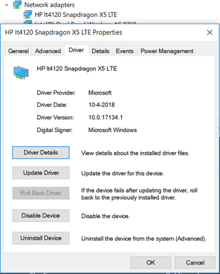

  • The driver details show that the Generic Microsoft driver is used (and not the driver I expected), and the evenlog shows a 'Device not Migrated message'.

  • I removed the HP drivers manually and reinstalled manually (sp89031).
  • I tried switching the LTE modem firmware to generic and then back to vodafone.

  Hello. I exactly experienced the same issue today. Suddenly my internet was gone and written “no internet”. I didnt install any update recently. My drivers are the latest version. But I dont know what happened suddenly and it atopes working.
I tried every way that I knew but again no internet and when diagnosed it said “enter a sim card pin2 to unlock your broadband device”. I replaced the sim with another sim but same error. I put the sim in another device and it worked so the sim card is working.
So after I tried many ways and failed I did system restore and after that everything worked fine. Still I dont know what caused the problem and what solved the problem.
