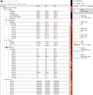

I have decided to install some monitoring tools to capture what was happening when just letting the unit run  (with and without programs running in the background). Not so much for me, because I am not computer expert, but I was hoping someone out there may have the same issue or a hint what is happening (I will also be in contact with HP on Monday, but if we manage to get this resolved I can also post an update here to purhaps help someone else). Below are the units specs and I have uploaded the screen shots of the hardware monitor and task manager at the time of 4 different freezes over 2 days. I can find no event errors that logged consistantly at these times. Just by watching the monitor and task manager I can see that as various hp and microsoft background processes start, the cores start to increase thier speeds (from normally running at 1406 MHz to 4720 MHz) and to heat up (normal temp 50C jumps to 70 - 90C) and the fan kicks in and then if it is going to freeze I don't have to wait long and then the fan goes really crazy until I do a hard reboot.

Monitoring the hardware during the night 22:00 <> 7:00 (non-working hours) my ZBook was idle!
The result below with a high core temperature is 93 celsius? my room temperature is 22.5 celsius this is insane?

The update to windows 11 hasn't changed anything regards to the high temperatures and freezing episodes. This still happens when Hp sureclick endpoint service, Antimalware service executable, System, Windows module installer and Service Host Windows update start their dance of death after a failed installation or update. But...under regular circumstances everything runs fine.
Just a suggestion, looking at your screenshot your Desktop Window Manager seems to have a high GPU usage. Typically it uses one to three percent of your GPU when idle. What you describe as frequent freezing for seconds could be something with the GPU (drivers, settings, screen resolution) causing lags in screen response?
