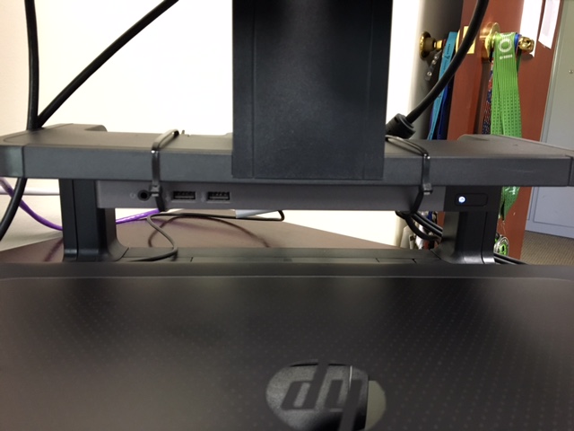

Update 3: The thunderbolt cable/connection is also a bit flaky. The short cord and placement of the dock allowed for the connector to wiggle free from the laptop with the slightest move of the laptop. To solve I secured the dock to the monitor stand with zip ties. The dock is actually upside down in the pics below. This orientation allows for the power button to be front-facing while keeping the cable stable and unstrained while plugged into the laptop.
