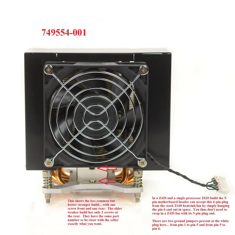

Cooling:  If you don't have a front bottom case fan get one... there are several HP kits that fit.  There is a black plastic Z420 front memory band airflow baffle that guides air up and out the power supply pulling it from out front up over the memory.  The rear bank has an "active" fan device.  I always add in that front air baffle if I'm maxing out a Z420.  Processor heatsink/fan:  The double large double cooling capacity one from the Z440 is a steal on eBay, and it fits perfectly for a Z420 and a single-processor Z620 build.  There are two types, and I now only buy the later stronger build.  You can use that 6-pin fan plug on the ZX20 5-pin CPU fan header just fine... hang pin 6 end out in space.  Here's a pic:
