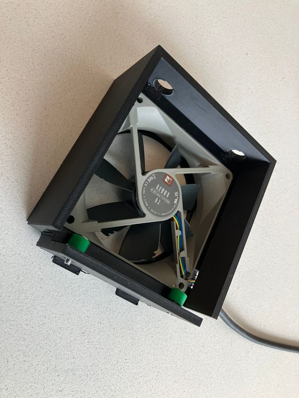

This is what I did.  I had to do a bunch of iterations before I got the geometry right; hard to measure at the bottom of the case, but it fits and will be screwed to the two holes which were already in the chassis.  They're 6-32 instead of metric.  Material is PETG although PLA  would have worked equally well.
I went with the Noctua fan because the cord was long enough. Even though I'd ordered the Foxconn fan with the same part number which shows in your photo, what I received was a short one.
The two screws are SS FH 6-32 x 5/8 and the green collars are thick PLA washers I printed because it was so hard to handle the screws  alone because of their location inside the case.
I'm probably going to post the STL and STEP files to Thingiverse, an online repository of designs of interest to people who have 3D Printers.

Nice work! That is far beyond a Ghetto Mod. I like your solution to getting a screwdriver down to the machine screws, and that Noctua fan looks great. I see you already have a forum member asking for the file(s) so he can print one himself. If you can please follow up with a link to a download site I'm sure many would appreciate that.
I just checked... HP PartSurfer does not have any of those original kits left and I bet they never will. So, your way is the best way to go now for a good safe install.
