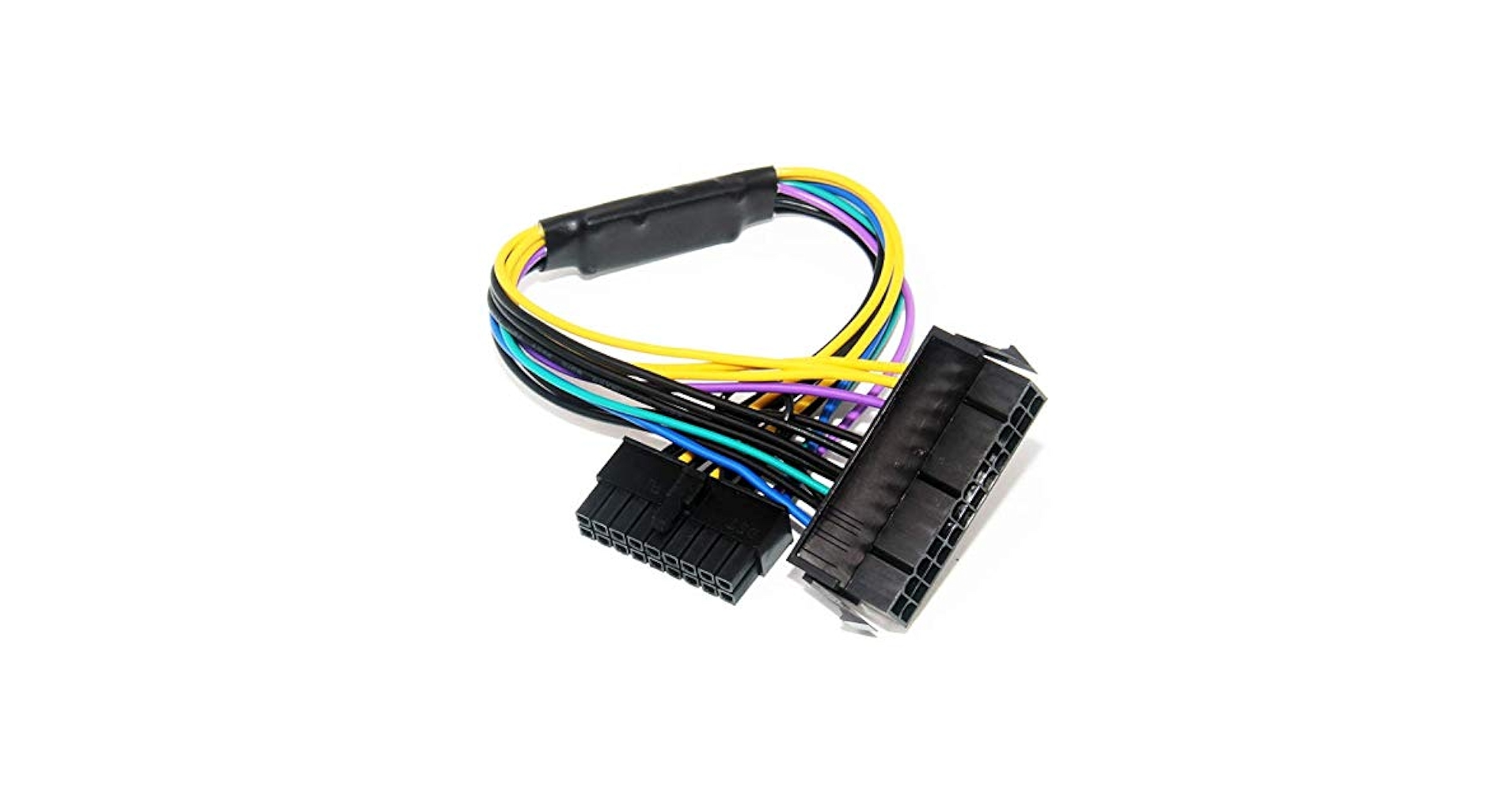

which brand ATX pwr supply adapter are you using? not all 18 to 24 pin adapters are of the same build quality

02-22-2022 11:24 AM
https://www.amazon.com/gp/aw/d/B08Q2TLWGW?psc=1&ref=ppx_pop_mob_b_asin_title
This is the one I'm using
02-22-2022 11:39 AM - edited 02-22-2022 11:41 AM
the adapter appears to be a good one visually, some of the cheaper eBay ones have poor connectors and thin wire strands
your stated symptoms indicate a short on the power rail, is the power supply a known good unit or a untested one?
