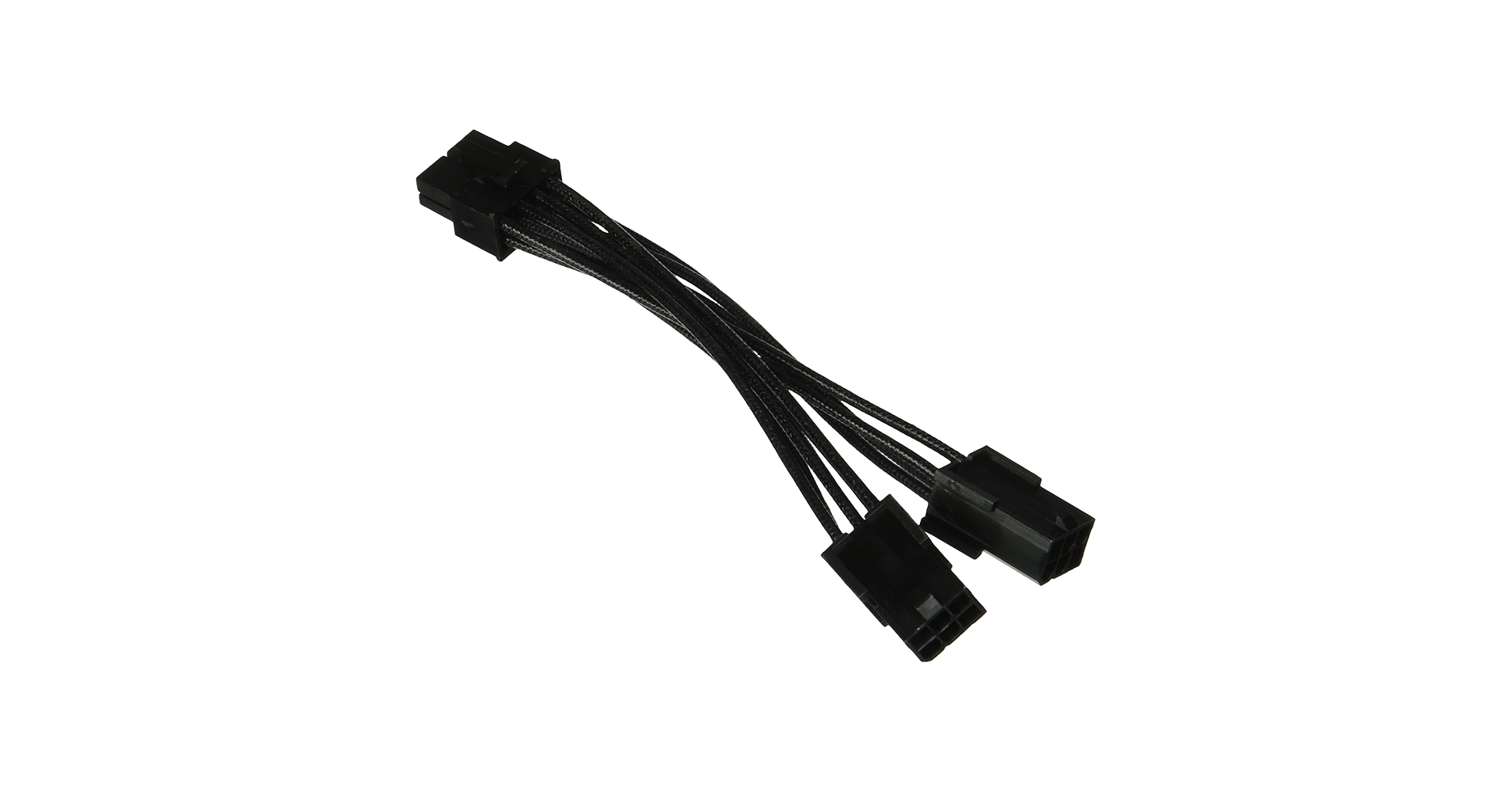

At the moment I have 2x(6pin) connected to a 8pin
and then a dual 6 to 8 pin adapter connected on the remaining 6 pin cable.

Would it make a diference if I used a single 6 to 8pin adapter instead of the dual 6 to 8 pin adapter im using?

I'm curious about the $30 cable- that's expensive- and whether it is proprietary with a different pinout and triggering the error. All the PCIe power cables I've ever used are yellow and black wires so it's possible to verify the pinout.
Consider trying  a couple of standard, yellow /black cables only to eliminate those as a possibility.  This is the 2X 6-pin to 1X 8-pin I use:
https://www.ebay.com/itm/C2PCIE6T8-10-2-x-PCI-E-6-PIN-COMBINE-TO-1-x-PCIE-8-PIN-10-MADE-IN-USA/26322...

Thanks for the tip on the black and yellow cable. I am going out to buy
https://www.bhphotovideo.com/c/product/914159-REG/startech_pciex68adap_pci_express_pwr_adptr.html

Thank you so much. My issue is now solved simply by changed the adapter I was using and just using a 6pin to 8pin. Worked like a charm! Much appreciated for your help kind sir.
