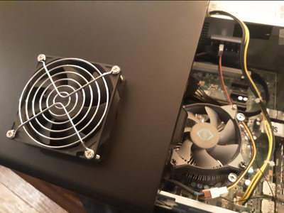

Dear Forum,
The thinking behind this modification was to substantially increase the internal positive pressure and increase the airflow -especially through the HP EliteDesk 800 G3 SFF's heatsink.
Installed a high performance 6 watt 90x90x25mm cooling fan on top of the chassis cover directly centered above the HP EliteDesk 800 G3 SFF's CPU heatsink/fan assembly and also removed the heatsink shroud. (I didn't think that the 800 G3 SFF shroud was particularly effective anyway, so good riddance.)
This CPU cooling modification is working very well: upon stressing the i7-7700K, instead of peaking around a blistering 99° C, the highest CPU temperature I observed was 85° C.
