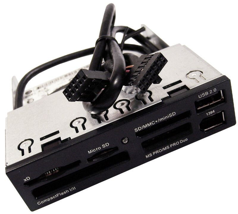

OK, now I get what you are going for.  Here is your HP media card reader, and it has the capability of providing In/Out data transfer both by USB2 and FireWire (1394):
HP USB-1394 MCR22IN1-5181 3.5in Card Reader Assembly P/N 468494-002 Spares P/N 507058-001
Below will be some pictures showing the two cables coming out of the reader..... USB2 and 1394.  I394 has kind of gone into history with the speeds of USB3.  I'm going to tell you what I would do and then answer your questions.
I personally would junk that media card reader and keep your very high quality 3.5 to 5.25 adapter.  I'd instead buy one of the HP media card readers I mentioned that has native USB3 output (I can get you the part number if you want that).  I would buy one of the HP "2x2" cards that uses the same Texas Instruments chipset as the Z420 motherboard does (all the ZX20 workstations use that same chip on motherboard).  I have posted in here all about that card which is excellent.  I would mount that card in the proper PCIe slot and feed the USB3 cable from the USB3 HP media card reader to the on-card "motherboard type" socket.  That way your card reader will have I/O performance way above USB2.  You already have a 1394 port on the front and rear of that workstation.
Now, if you want to keep what you have and live with USB2 speeds:  You can detach the current front 1394 cable and use the Media Card Reader's 1394 cable and attach it to the 1394 motherboard header.  That is on the bottom edge, second in from the rear.  See motherboard diagram below.
For the USB2 cable just plug it into one of the 3 internal USB headers.  They all are the same and each has a missing pin on one side that corresponds to the filled hole on the black plug at the end of the cable.  It thus can only go on one orientation.  That filled hole is called a "blank".
Power..... for USB3 and 1394 that comes in via the two cables from the motherboard headers.  USB2 is 5VDC at 500 mA for each of the two channels.  One channel will have 4 pins on the motherboard and the other will have 5.  1394 is 12VDC at 1.5A.  The technical and service manual will have the type of 1394 listed..... compare the speeds of that with that of USB3.

Some added pics of your card reader:

A little added info about speeds, and I'll go dig out one of my HP USB3 readers and its USB3 to USB2 adapters to add in a few more pics.  When you understand the speed differences you'll see why USB3 truly is the way to go unless you almost never use the card reader.
IEEE 1394 initially came out as the slower 1394a, which is what is available from your motherboard.  HP did release a faster PCIe 1394b card running at about twice that speed.  So, up front there your "Firewire 400" port will actually be a bit slower than USB2 (which runs at a max of 480 Mbps).  In contrast USB3 is about 10 times faster than either of those..... about 5000 Mbps.  This now is called USB3.1, generation 1.  USB3.1 generation 2 goes twice as fast at about 10,000 Mbps.
So, faster USB3 via the card I mention is worth thinking about, and the drivers for it are the same as for your internal USB3 on the Z420's motherboard.  As a result of using the same TI chipset the drivers for the motherboard also drive the card, and this incluses auto-install with a W10Pro64 installation..
