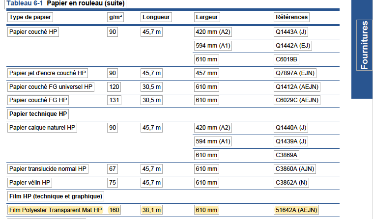

I don't understand, I have a DesignJet 111 (yes, an old lady, but it works very well for my needs).
On the official HP documentation, it says that in the supported media, there is "HP 160 Transparent Matte Polyester Film > ref. 51642A (AEJN)"
However, it doesn't work at all. As soon as you put on this kind of media, the light cell of the printer slides along the media, and the printer goes into error, ejecting the media.

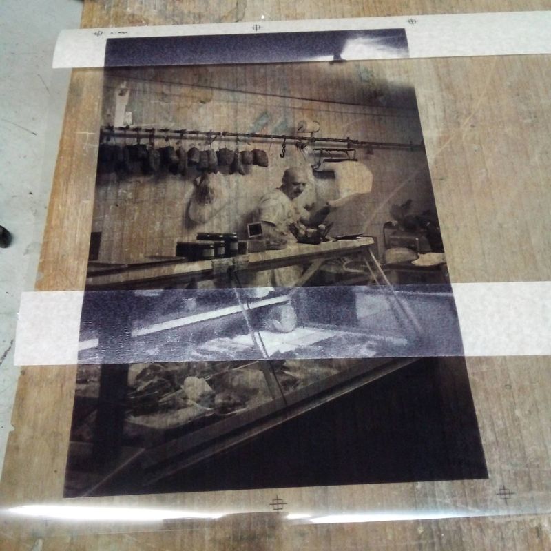

So I thought about it for a while and tried a trick; stick 2 pieces of adhesive paper; the first one on the edge of the transparent support and a second strip about 30 cm further.
There, the cell, does not detect any more error and the printer accepts to print without problem (proof in photo)
On the other hand, obviously, it would be necessary to make this handling with each document => madness!

I've had very good results from printing with HP polyester that comes with a strip of paper on either edge of the roll.  This allows the printer to "see" the edges of the material so it know there's media loaded.
If you're feeding sheets you might be okay putting something like painter's tape on the edges of the sheet.  It should do the same thing and will be easy to remove.  Anything that will reflect the light back to the sensor.

Good luck.  Your picture you posted looks very interesting.
