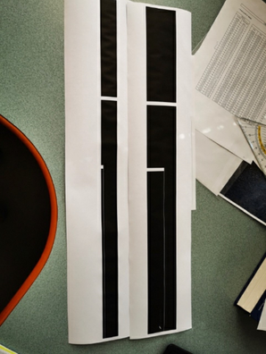

Hi. Is there any problems with DesignJet T520 drivers and Acad 2020. I can not print any normal pages, if preview shows me normal page, print is not normal. On 2017 version everything goes normal. Please if someane have the same issue plese give me feedback, i try with different drivers also with old ones. Thank you for help.

Evereything with normal paper size (A4 or A3) work normal but if i add custom paper size printer cannot recognize command (but problem is that sometimes it can) in 10 cases one case is positive and print is ok?

Hello,   The result is attached. This is with 755CM via ploter manager.
